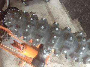

If you go to the hardware store, pick up about 200 small, 3/8 or 1/2 inch (depending on lug thickness on your tire) sheet metal screws an using a drill with a socket on the end, run them into the lugs on your d/s tire. Rear tire takes about 200 and if you are really brave do the same to your front. Ride like normal on ice. Dry pavement be becomes interesting tho. Maybe grab a second set of wheels and rubber so you can swap .

(01-06-2013 06:47 AM)MVBrutaleRider Wrote: If you go to the hardware store, pick up about 200 small, 3/8 or 1/2 inch (depending on lug thickness on your tire) sheet metal screws an using a drill with a socket on the end, run them into the lugs on your d/s tire. Rear tire takes about 200 and if you are really brave do the same to your front. Ride like normal on ice. Dry pavement be becomes interesting tho. Maybe grab a second set of wheels and rubber so you can swap . Will that work? I have tried to get my tires studded but none of the tire shops will do it for me, liability I guess. Motorcycle shops won't do it either. I don't want buy a stud gun just for one time use. Or maybe two if got the FZ studded. By the FZ is still running good and the forks are good! |

(01-06-2013 04:11 PM)VEGASRIDER Wrote:It does work... the only catch to it is that it destroys handling on dry pavement (metal and pavement dont play well) and they do occasionally fall out (potentially leaving shrapnel in the roads).(01-06-2013 06:47 AM)MVBrutaleRider Wrote: If you go to the hardware store, pick up about 200 small, 3/8 or 1/2 inch (depending on lug thickness on your tire) sheet metal screws an using a drill with a socket on the end, run them into the lugs on your d/s tire. Rear tire takes about 200 and if you are really brave do the same to your front. Ride like normal on ice. Dry pavement be becomes interesting tho. Maybe grab a second set of wheels and rubber so you can swap . The trick is that you want the longest possible screw (again, sheetmetal screws with the slotted hex heads) but make sure they are not too long as to protrude into the tire and potentially pop the tube. Just enough to dig firmly into the lugs of the tires (see pic) I wouldnt do it to your FZ. Tubless tires are a whole different game and require installation from the inside out and must be drilled first, then bolt (stud) installed and a nut on the end tightened to ensure a good air seal. If you are only using the studed tires on the bad days then go for it. If you plan to use them all the time I would suggest against it and find another method. Mind you, This is the poor mans way to do it. You can actually buy proper MC tire studs but they are pricey and the only real difference is that the threads are larger and deeper to bite into more of the tire (less chance of them coming out) See the attachment of my studded tire that I did last weekend. This one is probably overkill for your needs as you are just looking for a little something more. This took me about 35 minutes with a power drill and a nut driver attachment for it. - Justin "You were taking it easy right? Because I could keep up with you and from what I understand, I shouldn't be able to do that..." - Ken "No Neck"
