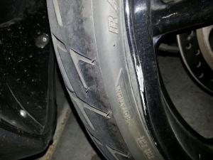

Hello everyone,
I'm new to the forum and I was wondering if anyone had any info that could help me with this. I have a 1993 CBR F2 that I am quite fond of. I was hoping to do my first track day in September to get better with my riding and cornering. Everything on my bike is set to go, the only thing I think that needs to be done on it is the lip of the front rim is ever so slightly bent out one one area. I'm not even sure how it happened or if it was already there when I got it a year ago. I'm thinking that might cause my bike to fail inspection and want to get it fixed. I can take off the wheel but I was wondering if anyone knew of a good place to take it to have the tire removed, the lip moved back and tire put back on without at a reasonable price. Thanks for the help! |

RE: Rim Fix
Post a pic of the bend.
2x4 can be used if its a very slight bend...leave tire on rim. Hubcap Annie will straighten it if it more than slightly bent...about $60. (They beat up the rim and straighten, so he coloring in that area will be trashed...and this requires that the tire be removed) --- Charlie don't surf! The Cake is a Lie! You're gonna love my nuts! I haven't seen Yayo... 09 Husqvarna 510 - "Bouncing Betty" 07 ZX-6R - "Crack" 07 Mean Streak Special Edition - "Blow" |

RE: Rim Fix
(07-23-2013 10:12 PM)got2go Wrote: Post a pic of the bend. I've heard about trying the 2 X 4 thing. Also also had someone else recommend Hubcap Annie's. Looks like I'll try both if needed. I've noticed no problems from it, no vibrations, tire leakage etc. Here's a couple of pics of it, please excuse the dirtyness of my bike. I got caught in the rain and hail last Saturday, big mess. |

RE: Rim Fix
Big rubber mallet from harbor freight might do the trick
